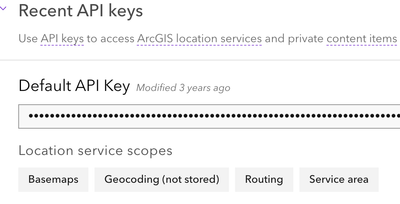

Ok, I copied the code from the sandbox and added my API key but I'm seeing the same error  (attached)
Is there something I need to turn on for my account to be able to use the route service?

As long as you have Routing and probably geocoding enabled for your key, should be fine.
AnthonyDAlessio
That was it.  I did not realize that these were not enabled by default, had to go in and turn them on for that API key.
