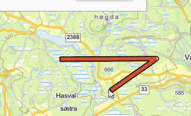

I need a line symbol with an outline so I have used a CIMLineSymbol with 2 layers of CIMSolidStroke, one of them with a CIMGeometricEffectBuffer.
Can the buffered element be made to stick to the 'parent' layer and not disconnect as it is shown on this GIF?

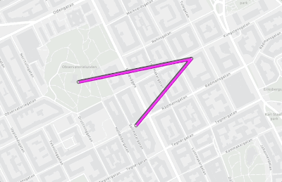

@ViktorSafar - what version of the API are you using? And how are you drawing/moving the symbol in your map?
I just tried to repro with this same symbol and the Draw class and could not. It works as expected for me - https://codepen.io/annefitz/pen/qBgmNBV?editors=100 (use the button in the top right to start drawing the line) 
If you could provide more info as to how this is happening, or even a reproducible example, that would be great. Thanks!

I am using 4.24.7
If I downgrade your solution to 4.24 I get the same issue. It's obviously been fixed so I'll just upgrade. Thanks!
