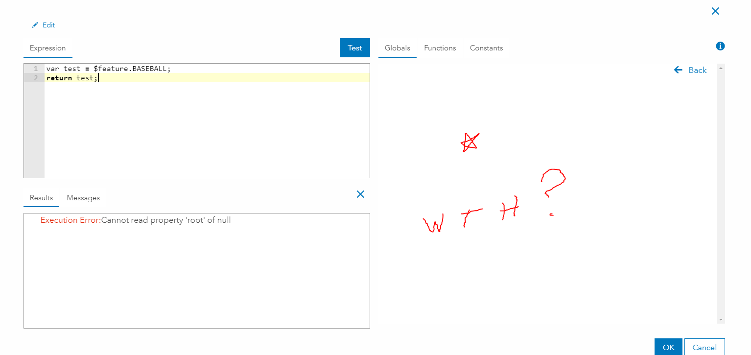

I am working with arcade expressions for a popup window and after only getting the error below I realized something else might be going on. Also I notice that no Global variables are available in the expressions reference pane?!
This is the error I get for any simple function...
Execution Error:Cannot read property 'root' of null
I have no problem doing this in other maps.
I am working with a simple "Parks" point layer, and the map service and feature service have the same result.

UPDATE 1: The error in firefox is Execution Error:e._profileGlobals is null (a little more helpful perhaps?!)

Sorry that's a temp work around for now, should be fixed within a couple of days

Try adding it as a MapService URL instead of the layer id
Society/Parks (MapServer)
That works.

That does work!
However the same isnt true for the feature service?!
Arcade expressions only on AGS hosted map service root? That can't be?!
What about getting it to work for an AGOL hosted feature services?

It worked the other day on feature service.  The AGOL update must've broke it.

Seems, during the proxy restriction AGOL unable to initialize the Arcade Editor using attribute collection with HTTPS (secured) service.
Anyway, you can perform the operation without Test it. Just click Ok, if expression is valid.. 🙂

Thanks everyone... its working this morning as expected!
