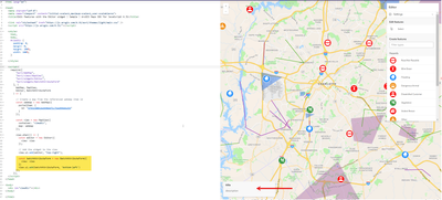

Jade_Freeman
Has anyone used the BatchAttributeForm included in the 4.31 release?  We have several use cases for batch editing I was excited when I saw this but it doesn't seem to do anything.  Wondering if it was released before it was fully ready.
https://developers.arcgis.com/javascript/latest/api-reference/esri-widgets-BatchAttributeForm.html
HeatherGonzago
Hi @Jade_Freeman this was inadvertantly documented too early. Our devs have been hard at work trying to get this functionality implemented in the not-too-distant future. This widget is just one piece to a bigger project when working with bulk attribute updating. The way that it is currently written, you will not be able to do much with it, nor is any of this fully supported until we get all the pieces implemented and working as expected. We will most definitely keep everyone informed on when this will take place and apologize for causing any confusion.
