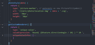

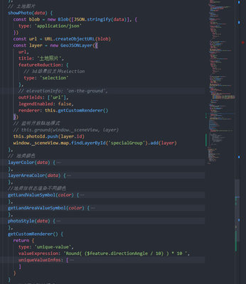

How to solve the problem of using GeoJSONLayer3D scenes, when rotating the map, the direction of the photo also changes (where I used the featureReduction attribute)
Below is my partial code:

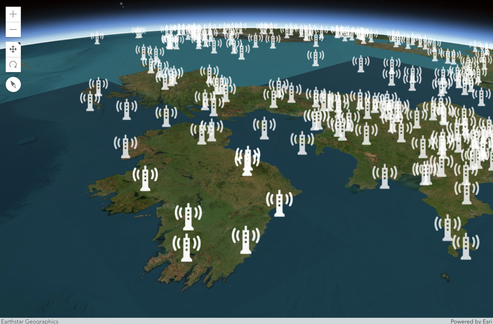

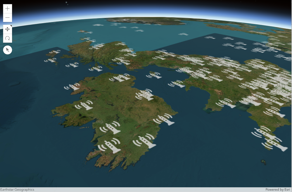

I'm assuming the PictureMarkerSymbol is currently shown as a billboarded icon in the 3D scene, this is the default behavior. You can drape them to the ground by changing the elevation info on your GeoJSON layer to mode: "on-the-ground", as explained here: https://developers.arcgis.com/javascript/latest/api-reference/esri-symbols-IconSymbol3DLayer.html
Here are two CodePens showing the difference:
Billboard icons
https://codepen.io/arnofiva/pen/poOQGoG/1b63bec0e62aa8f79f51064e7a3b360c?editors=1010

Draped icons
https://codepen.io/arnofiva/pen/WNgYPYq/f51cf1af782c07af439aa7eed42760a4?editors=1000

When I set the featureReduction property, the elevationInfo property will become invalid
