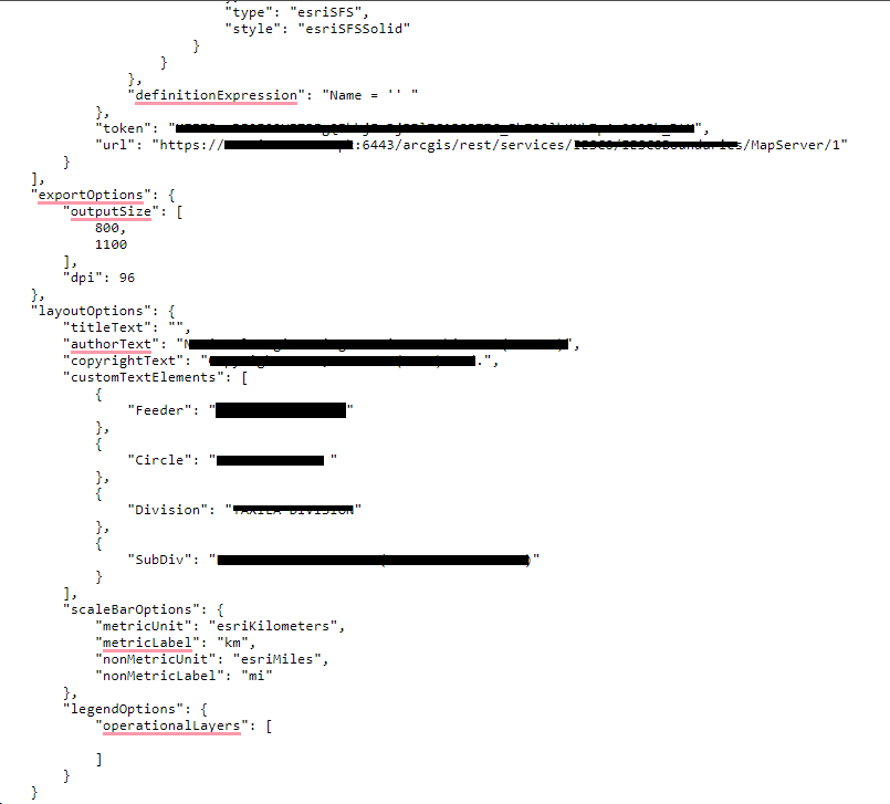

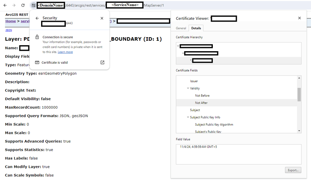

SSL certificate is valid up to November, 2024 and configured through domain name instead of IP. So map services are accessible through the domain name URLs when directly accessing through the web browser with a valid certificate message in the browser (See Attachment SSLCertificateDetail.png). However, the problem is map services are not accessible through PrintTask. Moreover, map services are secure and a Token is also passed in "Web Map as JSON" (PrintTask JSON). (See Attachment JSON-1.png and JSON-2.png). SSLCertificateDetailSSLCertificateDetailJSON-1JSON-1JSON-2JSON-2
You can see in the attached images that for testing purposes I am trying to get print from the printTask without using our custom web application but no luck so far. Once I get print directly from the PrintTask most probably it will work through a custom web application.

@MamoonRasheed
Thanks for clarifying. Sorry that I wrongfully assumed you didn't have valid certificate for your :6443 port. You are right about other things you mentioned about web adaptor.
Can you pls do me a favor?
  • pls log (remote or physically) on to your server machine, where the print service runs as the ArcGIS SOC user
  • open a web browser (maybe in Incognito mode to avoid any local cache)
  • try to access your map services https://<domain-name>:6443/arcgis/rest/service/<service-name>/MapServer
  • see if you can access this url w/o get prompted for anything
  • if you happen to have ArcGIS Pro installed on that server machine, I'd like you to access your map service the same way in Pro. And see if you can access that w/o getting prompted with any dialog box or anything.
