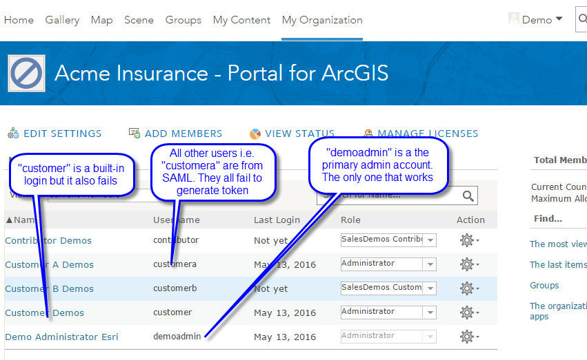

AkakpoAgbago
I am having exactly this same issue with ArcGIS Server 10.4 federated with a Portal for ArcGIS and using its SAML enterprise login to authenticate users.
I can only generate tokens using the Primary Admin Account. Only this works. Any other user fails although those users can login fine directly to the Server or Portal and use their map services without problem.
Generate a token is the problem with any other user than the primary admin account via
https://[server FQDN]/arcgis/admin/generateToken
or
https://[portal FQDN]/arcgis/sharing/generateToken
Is this a bug? and what's the solution or workaround?
