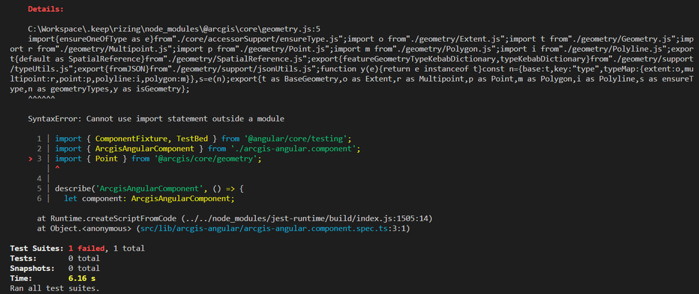

Trying to use the ArcGIS JS API in a unit test in Jest results in an import error:
Environment:
OS: Windows 10
Node: v20.1.0
Setup: nx repo > library > jest unit test
This issue can be found by simply creating a new NX monorepo/project and creating a TypeScript library and trying to use any ArcGIS JS API class within a Jest spec file (unit test).
Example:
`my-test.spec.ts`
// This import will fail!
import { Point } from '@arcgis/core/geometry';
describe('my test', ()=>{
  it('will fail', ()=>{
    new Point({ latitude: 42, longitude: -72 });
Steps to Reproduce:
  1. git clone https://github.com/rustygreen/arcgis-js-api-issue-example.git
  2. cd arcgis-js-api-issue-example
  3. npm install
  4. npm run test -- arcgis-angular
  5. 🔥 test will fail with import error

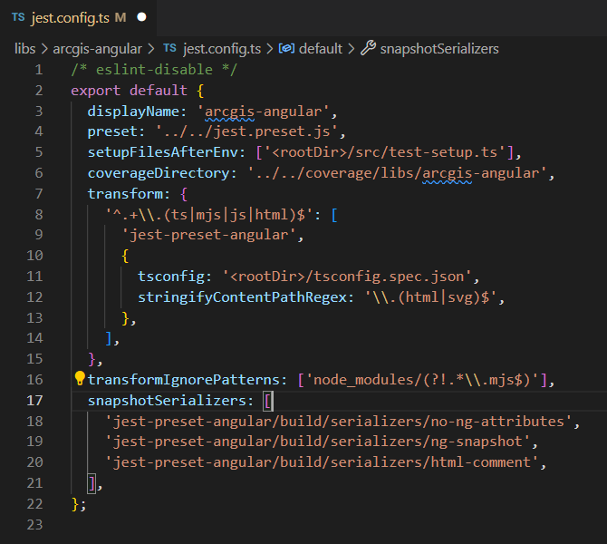

RussellMGreen
The current Jest config in the sample repo should already be handling this dynamically (unless I'm missing something):
arcgis-js-api-issue-example/libs/arcgis-angular/jest.config.ts at main · rustygreen/arcgis-js-api-is...
Also, just to note; you can take Angular out of this mix and the same issue will occur. I just happened to create the library as an Angular library using the NX cli.

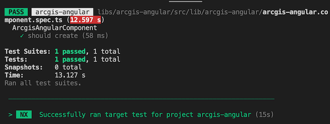

RussellMGreen
Yep, that solved it. Thanks, @AndyGup!
