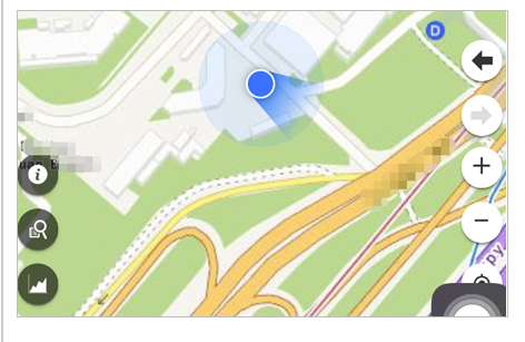

Hello,
I am wondering how to get the geolocation icon in the ArcGIS JS API 4 locate widget to look and behave more like the My Location Widget from the WebAppBuilder on a mobile device. I am aware that WAB uses JS API v3 but I would think it must be possible to get similar look and  behavior in v4. The WAB widget on a mobile device has an accuracy buffer and the flashlight that shows the direction you are facing. I also tend to believe in my own comparison using the same device at the same location, the GPS accuracy of the My Location Widget in the WAB was better than the location widget in ArcGIS JS 4 API. Do they both not use HTML5 Geolocation? You can see in the screenshots below the visual differences between the two widgets.

4x does use the geolocation api, we just don't have the accuracy symbology. You can add it though with the info from the widget. Here's a sample.
https://codepen.io/odoe/pen/zYpmEMB?editors=1000
You can even add a line or polygon for the heading from the widget info.

Thank you for the codepen. I do appreciate that. I am more interested in the compass direction symbology. If this is not available, would ESRI be willing to provide a working example of this functionality on ArcGIS JS v4? I understand I can do this myself with the heading information but it would be nice to have a working example with the correct symbology. Other mapping platforms such as Mapbox have these features available on their widgets.

The Locate widget uses the geolocation api of the browser, so it's completely device dependent at that point. You can pass geolocation options to modify the max age and timeout if you like.
https://developers.arcgis.com/javascript/latest/api-reference/esri-widgets-Track.html#geolocationOpt...
We don't have an example on hand showing the heading, but you can update the graphic of the Track widget to show an arrow based on the heading, you can even change it based on other results of the geolocation api like speed and altitude.
https://developers.arcgis.com/javascript/latest/api-reference/esri-widgets-Track.html#graphic

@BobCowling2  quick update on your original posting above, I've created an enhancement request to add an accuracy circle and compass heading symbol to the Track Widget.
