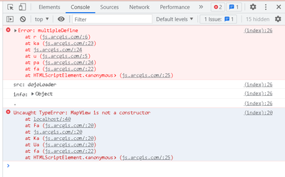

Is there a way to use ArcGIS Javascript on ASP.NET Core website. I've been trying to use it but it is causing an error like this.
I tried to follow the get started documentation.

Well, I haven't used ASP in years, so I spun up a new project locally and it looks like the default app uses a local jquery and bootstrap. This is where the error comes from because jquery has a require method it uses. We can work around this in the "Pages/Shared/_Layout.cshtml" file with a dojoConfig to define where the local packages can be loaded from.
<script>
    var dojoConfig = {
    packages: [
        location: location.pathname.replace(/\/[^/]+$/, "") + "lib/jquery/dist",
        main: "jquery.min",
        location:
            location.pathname.replace(/\/[^/]+$/, "") + "lib/bootstrap/dist/js",
        main: "bootstrap.bundle.min",
</script>
<script src="https://js.arcgis.com/4.22/"></script>
Then in your "wwwroot/js/site.js" file, when you load the JSAPI and require the modules, you can load the jquery and bootstrap stuff.
require([
  "esri/WebMap",
  "esri/views/MapView",
  "jquery",
  "bootstrap"
], function (...) {...})
This fixed the issue in my local app, should fix the issue for you too. Now I feel like I should do something with dotnet...

GavinBoyd
The way to get around this error is to comment out this section of your shared _layout.cshtml view
<script src="~/lib/jquery/dist/jquery.min.js"></script>
<script src="~/lib/bootstrap/dist/js/bootstrap.bundle.min.js"></script>
<script src="~/js/site.js" asp-append-version="true"></script>
@RenderSection("Scripts", required: false)
It appears to conflict with any arcgis sdk of higher than 4.15
