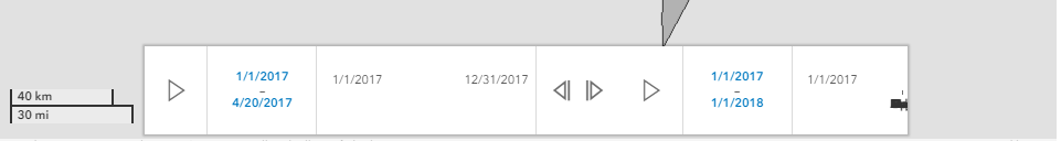

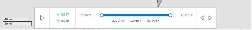

The first time the dropdown is selected the time slider displays correctly:
However when a user selects another option from the dropdown the timeSlider appears as below:
I have tried to set the view to null to no avail.
What can the issue be which is making the timeSlider not render correctly ?
