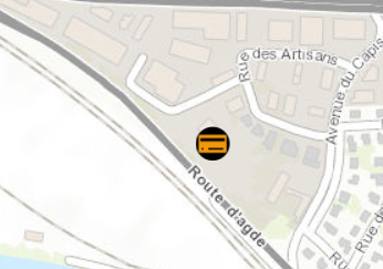

The symbol in the web map is correct

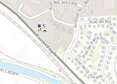

But when we export our app and deploy it to our web server, we have this "Broken" symbol

In fact the web map was copied from a portal 10.5 to our new portal 10.9.1 this maybe makes this symbol broken
Also the version of the JS API used in the WAB. The app modified was fisrtly created in a WAB version < 2.25 using the JS API version 3.37 and uploaded to the WAB 2.25 wich using the JS API 3.42 version
I had to make all this elements homogeneous : working with the WAB 2.25 and the appropriate JS API version 3.42 and the symbols are displayed well
I think, it necessary to work the WAB and its JS API version
