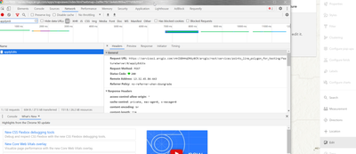

Hi, can you open the service in a webmap and test if the edit works? Open up the developer console when you do that to see the applyEdit request. Check and match your request against what the webmap edit uses.
LoganMichaels1
Both of the requests are identical between the webmap and the web app. Both run successfully and return updateFeatures information.
