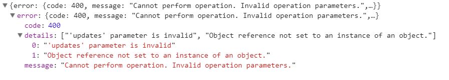

Hi Thomas,
I found an error
So I changed to "editFeature.attributes" then I got another error below.  Do I have to create a new Graphic object for the update?  If so, how?
// before
var edit = {
          updateFeatures: [editFeature]
// after
var edit = {
          updateFeatures: [editFeature.attributes]

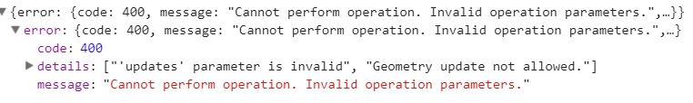

ThomasSolow
Hmm, interesting.  I would try this and see what happens:
var clonedFeature = editFeature.clone();
delete clonedFeature.geometry;
var edit = {
  updateFeatures: [clonedFeature]
The first error suggests to me that you can't edit the geometry on the graphic in question.  Whether this is a limitation of applyEdits or a setting on your feature service, I'm not sure.  That sample will clone the graphic in question and delete the geometry property.
by Anonymous User
Not applicable
Hi Thomas,
Thank you so much for your help!!  I made it work.  The code "delete clonedFeature.geometry;"  didn't work so I created a new Graphic object and assigned "attributes".  It worked, but this is the way to update the data?  I think it would be very helpful if this information is added to API reference.
var graphic = new Graphic();
graphic.attributes = editFeature.attributes;
var edit = {
   updateFeatures: [graphic]
Again, thank you so much!!
RobertScheitlin__GISP
MVP Emeritus
Makiko,
   I think you are running into this because of your feature service setting not allowing geometry updates. If you change that option on your feature service you would not have this issue.
KenBuja
MVP Esteemed Contributor
That would be a change from 3.x. I have a hosted feature service that only allows for attribute updates, but I am able to use applyEdits using the selected features from the feature layer without stripping the features of their geometry.
MVP Emeritus
Ken,
  I agree it is a change from 3.x. But not real surprising though.
