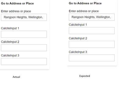

Hello,
Has anyone been able to update the calcite variable --calcite-label-margin-bottom and have that take effect?
I have tried applying a style with this variable set to the <CalciteLabel> element, and also to a wrapping <div>, but I do not see any change with either approach. I'm trying to change the calcite label element's margin-bottom from 12. I am working in React and bringing in Calcite via esri/calcite-components-react.

@BenElan Here is an app to reproduce (attached .zip). See readme.md for build/run steps
The problematic CalciteLabel wraps an address typeahead, built from a CalciteInput + CalciteDropdown.
I actually found a workaround solution for what I was trying to do, but the original issue appears to remain. Setting this calcite variable does not affect the CalciteLabel containing my address typeahead.

Hi @BenElan
That was it! The variable is working for me after upgrading esri/calcite-components-react to 0.30.0, and also making sure esri/calcite-components is upgraded to 1.0.0-beta.93.
