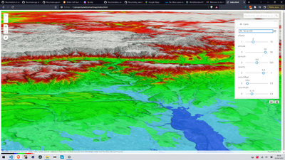

Hi ESRI community,
I have a simple problem I believe,  in a basic map setup, I can add a layer like this
map = new Map({basemap: "topo-vector" });
new MapView({ map: map,....});
map.add(new ImageryTileLayer({url:".../Terrain3D/ImageServer"}));
but when I zoom too much in the layers disapears,
my question:
how can I force the display of last available Level Of detail ? to be clear, I don't want to limit the mapzoom to the max layer's LOD, I want to zoom as much as possible even if pixelated
in advance for your help a big thx !

yes of course, it's this one :
https://elevation3d.arcgis.com/arcgis/rest/services/WorldElevation3D/Terrain3D/ImageServer
I use it in combination with a RasterShadedReliefRenderer to colorize the map elevation with the colorRamp
It works like a charm from a far, but it's very frustrating when I zoom too much in I loose the colored layer, I made this tool to find new spots to pratice my sport, but from so far it's useless sadly ...
With https://elevation3d.arcgis.com/arcgis/rest/services/Elevation/World_Hillshade/MapServer (TileLayer)  I can zoom how much I want ... but not use RasterShadedReliefRenderer  and ColorRamps
