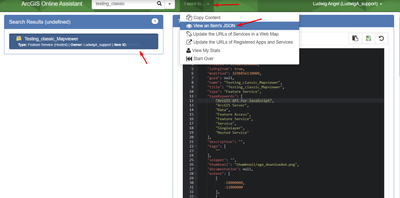

With some help from Esri Support, I figured out how to delete the symbology of a layer that has been saved in the new map viewer and restore it to work in the classic map viewer.
  1. Sign in to ArcGIS Online Assistant at: https://ago-assistant.esri.com
  2. Search for the feature layer and select "I want to.." >View an Item's Json
  3. Click on the edit icon (Pencil) and remove "ArcGIS API for JavaScript" line under type keyword
4. Edit the Data JSON object to be "{}".
After you do that, then, when you view the layer in the classic map viewer, or an app using ArcGIS Javascript API, then the symbology saved on the layer will appear.
