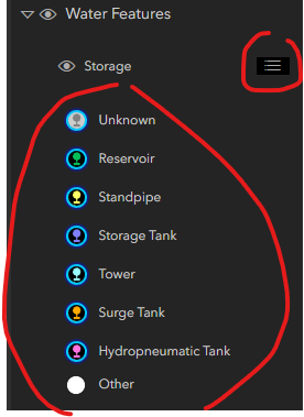

Thanks for taking another look. If I use the code above it removes the legend within the layer list.
JoelBennett
MVP Regular Contributor
The solutions provided are specific to the samples, because that's how your original request was framed.  If you copy and paste the code into the samples, you'll see the solutions do work, and do add an opacity slider into the layer list along with the legend.
I can't tell why it doesn't work in your application, because I can't access it or its source code.  Perhaps since the code I've provided is specific to the samples, maybe you included the condition that restricts the modifications to a layer with the title "Census Tracts" (line 24 in both snippets).
