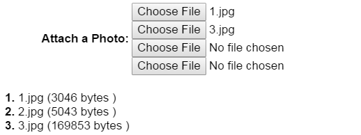

JoshVan_Kylen
Here is an updated solution that works rather well.
Known issue/s: Selecting a file and then changing your mind will cause a new file to be added to the list rather than changing the selected file.
Potential Improvements: Give the user a way to remove selected files if they change their minds.
Portion of the HTML form
<input id="txtFileName" type="text" class="txtFileName" readonly="readonly" style="margin-left: 0px; width: 100%" required />
                    <div id="divFileSelectComponent" class="fileinputs" title="Select File to Upload">
                        <form id="formFileUpload_1">
                            <input id="file_1" class="filehidden" accept="video/*,image/*," size="25" type="file" name="attachment" onchange="fileUploadChange('file_1')" />
                        </form>
                    </div>
        <div id="SelectedFilesList"> </div>
        <div id="CommentValidationMsg"> </div>
        <div class="dijitDialogPaneActionBar" id="CommentButtons">
            <button data-dojo-type="dijit/form/Button" type="button" data-dojo-props="onClick:function(){AddComment();}" id="SubmitComment">Submit</button><!--ValidateComment AddComment();-->
            <button data-dojo-type="dijit/form/Button" type="button" data-dojo-props="onClick:function(){CancelComment();}" id="cancelComment">Cancel</button>
        </div>

                var formID = "formFileUpload_" + intCurrentFile;
                var fileInputID = "file_" + intCurrentFile;
                var z = document.getElementById(fileInputID);    //document.getElementById(formID);
                var file = z.files[0];
                var FileName = "NA", FileSize = 0;
                if (z.files.length == 0) {
                    console.log("!!! No file !!!", formID, fileInputID);
                } else {
                    FileName = file.name; FileSize = file.size;
                    console.log("!!! file !!!", file.name, file.size, "form & file", formID, fileInputID);
                //email notification about the error
                try {
                    var EmailHandler = "/Map/HandlerEmail.ashx?Error=" + err + "&FileName=" + FileName + "&FileSize=" + FileSize + "&Misc=intCurrentFile: " + intCurrentFile + ", newObjectId: " + newObjectId + ", intCurrentFile: " + intCurrentFile + ", intFileUploads: " + intFileUploads;
                    dojo.xhrGet({
                        url: EmailHandler,
                        load: function (result) {
                            console.log("!!! Sending Email", result);
                catch (err) {
                    console.log("!!! Email ERROR:", err);
                hideMapBusyIndicator();
                dom.byId("userFeedbackMessage").innerHTML = "Something Happened <br/>" + err.message;
                showUserFeedbackMessage();
                DestroyFileUploads();
fileUploadChange = function (inputID, results) {
            intSelectedFiles++; intFileUploads++; console.log("intFileUploads", intFileUploads, "intSelectedFiles", intSelectedFiles);
            //console.log("inputID", inputID);
            //console.log("results size", results.size);
            x = document.getElementById(inputID);
            if ('files' in x) {
                if (x.files.length == 0) {
                    txtFileSelect = "Select a file.";
                } else {
                    if ('files' in x) {
                        txtFileSelect += "<br><strong>" + intSelectedFiles + ". </strong>";
                        var file = x.files[0];
                        if ('name' in file) {
                            txtFileSelect += file.name;
                        if ('size' in file) {
                            txtFileSelect += " (" + file.size + " bytes )";
            } else {
                if (x.value == "") {
                    txtFileSelect += "Select a file.";   //Select one or more files.
                } else {
                    txtFileSelect += "The files property is not supported by your browser!";
                    txtFileSelect += "<br>The path of the selected file: " + x.value; // If the browser does not support the files property, it will return the path of the selected file instead.
            document.getElementById("SelectedFilesList").innerHTML = txtFileSelect;
            var formID = "formFileUpload_" + intFileUploads, fileInputID = "file_" + intFileUploads, listID = "list_" + intFileUploads;
            var fileInputForm = domConstruct.create("form", { id: formID });
            var inputNode = domConstruct.create("input", { id: fileInputID, type: "file", name: "attachment", value: "", accept: "video/*,image/*,", class: "filehidden", onchange: "fileUploadChange('" + fileInputID + "')" });
            var fileList = domConstruct.create("output", { id: listID });
            domConstruct.place(fileInputForm, "divFileSelectComponent");
            domConstruct.place(inputNode, fileInputForm);
        DestroyFileUploads = function () {
            console.log("!!!DestroyFileUploads!!! intFileUploads", intFileUploads, "intSelectedFiles", intSelectedFiles);
            //Clean up as preparation for another comment submittal
            //Loop through starting with the 2nd file upload control
            for (var i = 2; i < intFileUploads + 1; i++) {
                var formID = "formFileUpload_" + i;
                var fileInputID = "file_" + i;
                console.log("formID", formID, "fileInputID", fileInputID);
                if (dojo.byId(fileInputID).value != "") {
                    var x = document.getElementById(fileInputID);
                    var file2 = x.files[0];
                    console.log("file name", file2.name, "size", file2.size);
                } else { console.log("No file"); }
                //Destroy the generated forms and file upload controls.
                domConstruct.destroy(fileInputID);
                domConstruct.destroy(formID);
            //clear the list of files and reset the variables
            dom.byId("SelectedFilesList").innerHTML = " "//SelectedFilesList
            intFileUploads = 1;
            intSelectedFiles = 0;
            txtFileSelect = "";

Sort of hacky, but I made this work with:
<form id="newForm">
<div class="form-group" id="crDoc1">
<input class="form-control" id="crDocInput1" type="file"/>
</div>
<div class="form-group" id="crDoc2">
<input class="form-control" id="crDocInput2" type="file"/>
</div>
<div class="form-group" id="crDoc3">
<input class="form-control" id="crDocInput3" type="file"/>
</div>
</form>
Several inputs for file inside of one form node, with no name="attachment" on any.  Then on a button click:
docInputs = ["crDocInput1", "crDocInput2", "crDocInput3"];
for (k=0;k<docInputs.length;k++){
if (document.getElementById(docInputs).files.length != 0){
document.getElementById(docInputs).name = "attachment";
var formNode = document.getElementById("newCheckForm");
relatedTable.addAttachment(objectId, formNode, function success(success){
console.log(success);
}, function error(err){
console.log(err);
document.getElementById(docInputs).name = '';
This takes a list of the file inputs, loops through them and if they are not empty, assigns the "attachment" name to the input, submits to the appropriate objectID, and then removes the "attachment" name.
