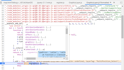

var GraphicsLayer = GraphicsLayer.createSubclass({
            declaredClass:"egova.layers.GraphicsLayer",
addGraphic:function (idlayerTaggeometrystyleattr,
                    hStylepopupTemplate) {
                var graphic = new Graphic({geometry:geometry});
                this.setSymbol(graphic,style);
                graphic.style = style;
                graphic.attributes = attr;
                graphic.id = id;
                graphic.hStyle = hStyle;
                graphic.layerTag = layerTag;
                graphic.extent = geometry.extent;
                popupTemplate&&(graphic.popupTemplate = popupTemplate);
                this.add(graphic);
                return graphic;

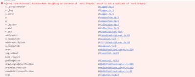

when to add a graphic to graphicslayer,console prints the errors"Accessor#set Assigning an instance of 'esri.Graphic' which is not a subclass of 'esri.Graphic'",what's the problem?

the error doesn't  repeat in codepen,but the same code will print the error every time when to use method addGraphic in local enviroment

The problem hasn't been solved.Maybe the inheritance has a problem in strict mode.Is there anynone has a solution?
