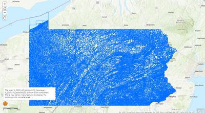

JohnGrayson
Esri Alum
The layer displays via the online Map Viewer, but there are many complex features at the default minimum scale, so you might want to adjust it so the feature visibility is more appropriate for the type of data.
