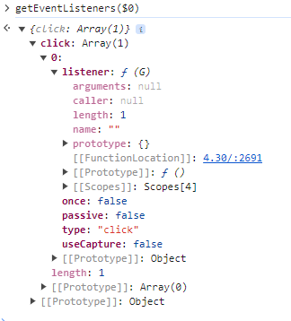

I attempted to trace the click event after the widget are generated on both the stand-alone and Drupal maps. I looked at the Zoom-In and Zoom-Out code block
<calcite-button class="esri-widget--button" title="Zoom in" alignment="center" appearance="solid" kind="neutral" icon-start="plus" scale="m" type="button" width="auto"></calcite-button>
And I found that the click event I get from Chrome Dev console getEventListeners($0) are different
Stand-alone map where Zoom and Home are working

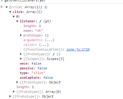

Here is the on the fly map where the zoom and home widget are not working
If you look at the FunctionLocation object, the stand-alone map is executing line 4.30/2691 but the on the fly map is executing zone.js:1724
Can someone explain to me why this happening and maybe give me some pointers on how I can get around it?

Hi @AllenHuang, This might be related to a known Angular bug that affected the SDK's widget buttons. Make sure you are running zone.js 0.14.5 or greater. For more info: https://github.com/Esri/jsapi-resources/tree/main/core-samples/jsapi-angular-cli#known-issues

I forgot to mention that I'm loading the 4.30 SDK by CDN so I am loading whatever zone.js that CDN loads for me.
I not building the map as an Angular component. I am only using Angular to load the ArcGIS JS and CSS with createElement('link') and createElement('script') after a page is created.
So Angular is probably interfering with the widget. I'll look into it.
