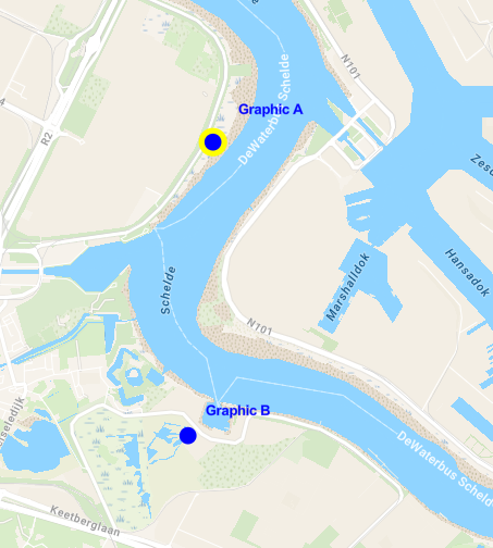

Found a bug with layer's labelingInfo when adding, updating or deleting graphics (with applyEdits).
Made a codepen to reproduce this issue:
https://codepen.io/michaelk95/pen/jOjKrqx
Steps to reproduce:

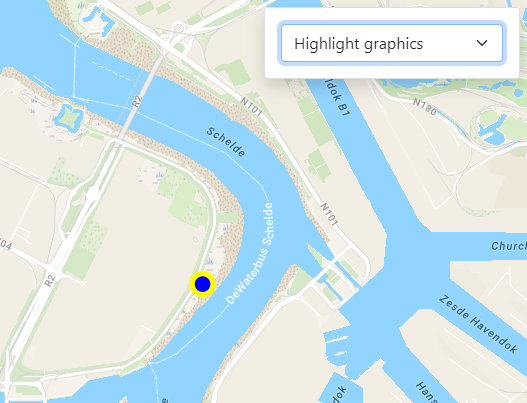

  1. Run the codepen - default filter view: all graphics
  2. Select 'highlight graphics' in the top-right widget - filter view: highlight graphics

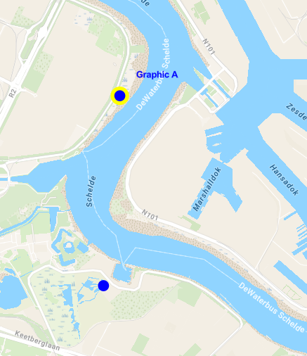

    label not visible
  3. Switch again
    label graphicB not visible
issue: labels are not visible (when zooming in or out, the labels will be visible again.)
