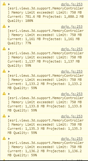

In console, I however see this error/warning and the loading of the basemap itself is taking a lot of time.
Is this the reason why my layers are not visible or something else?

  1. No console/network error other that the Memory violation warnings which I see
  2. The Pipeline Feature layer works perfects fine in 2D even in the starter/sample app, but the moment I shift to SceneView, the layer doesn't show up on map. However, the 0?f=pjson&token=<> URL in Network tab - which is the layer URL gets called successfully and no issues. Even port queries work fine.

    I even tried with adding a simple renderer of line-3d, but then the Memory Exception starts.

    Memory warnings:
