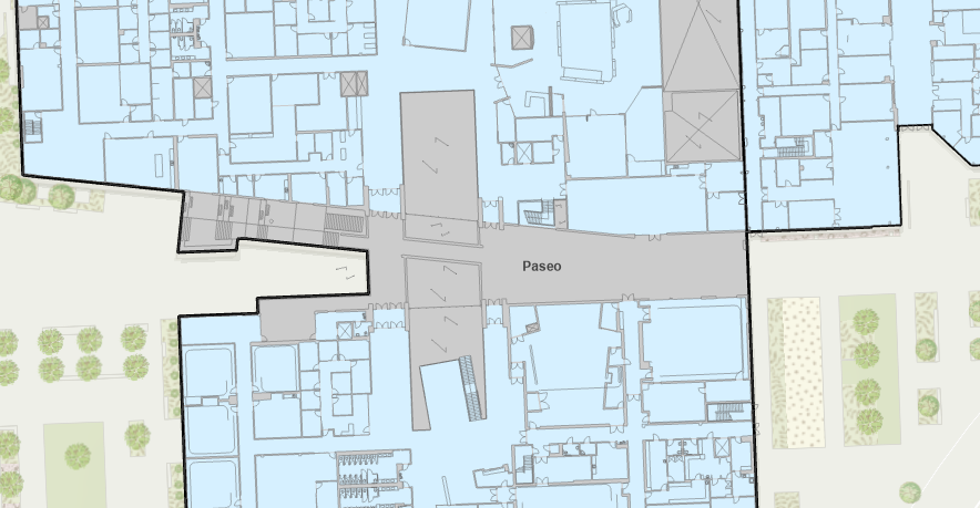

All of those transition features are on the second level of a building that opens up to an outdoor paseo. For context, the building is on a hill, so the east side "ground level" is floor 2, and the west side ground level is floor 1. The building is also split on the second floor, with a paseo that runs through it. Here is the second level floorplan for reference. Blue units are indoors, and the gray with black border area is the level feature.

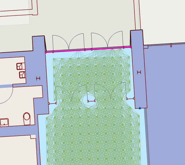

Here is the output of the tool I am getting:
Floor 1: works as expected
Floor 2: fails to create a transition

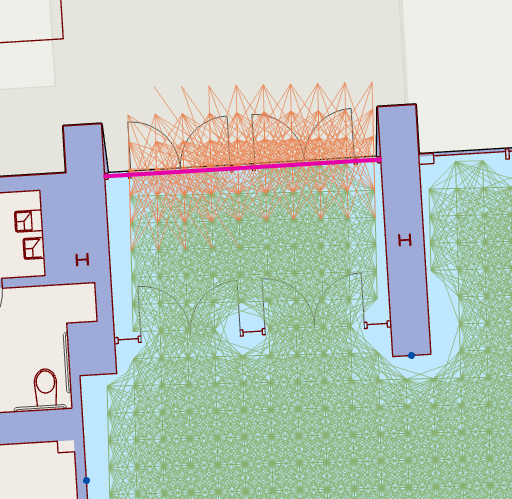

I am going to try adjusting the Levels and Transitions geometry. We have been playing around with the idea of moving the Transition line to closer to edge of the facility instead of right at the door threshold, and treating the paseo as more of an interior space than exterior. That way when people are just walking through the paseo to go from one side of building to another, it does not have to try to switch between IPS and GPS (which cause a lag and possible confusing when navigating) and instead will only switch to GPS once you have left the building as if you are walking to another building. Something like shown here, current transitions are in pink, but new ones would be the orange lines.
I don't think that is causing my particular issue but it's something we want to try anyway, so I will report back on if I have the same issue with these new transitions or not.

I ended up editing my Levels and Transitions geometry as mentioned above and ran the tool again before seeing your ask to send the data. It created the Derived Walkable Features as expected, so we are just going to roll with that way. But I will still send you my gdb so you can take a look and see anything that may help the functionality in the future.
