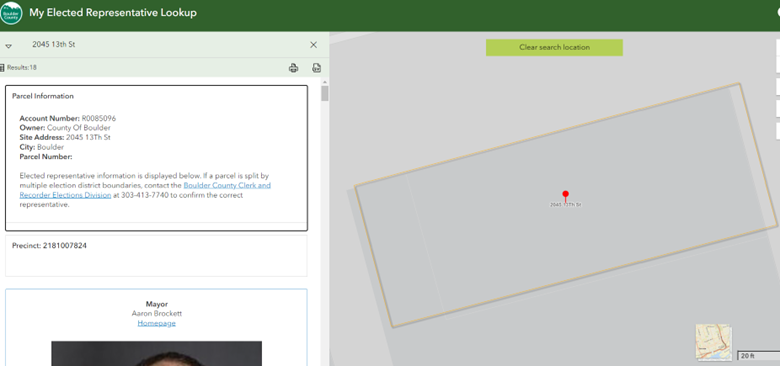

Thanks for the additional information. When I set the scale setting under the Style Results section, the scale setting isn't honored after the search is made. The map zooms to the same level, which is the parcel level. Here's a screen shot of my results:
Scale setting set to city zoom levelScale setting set to city zoom levelMap zooms to parcel level after search instead of city level as specified in the scale settingsMap zooms to parcel level after search instead of city level as specified in the scale settings
You can see I set the scale setting to city, but the map zooms to parcel level after the search instead of city level.

BethRomero
Are you trying to set the app to zoom out to a smaller scale from what it would be? Is there any way you are able to share your application?
MollyWatson1
Hi Beth, the apps are already shared publicly. You can view one of them here: https://bouldercounty.maps.arcgis.com/apps/instant/lookup/index.html?appid=b4a5c722b4b04cbabdfdea187...
