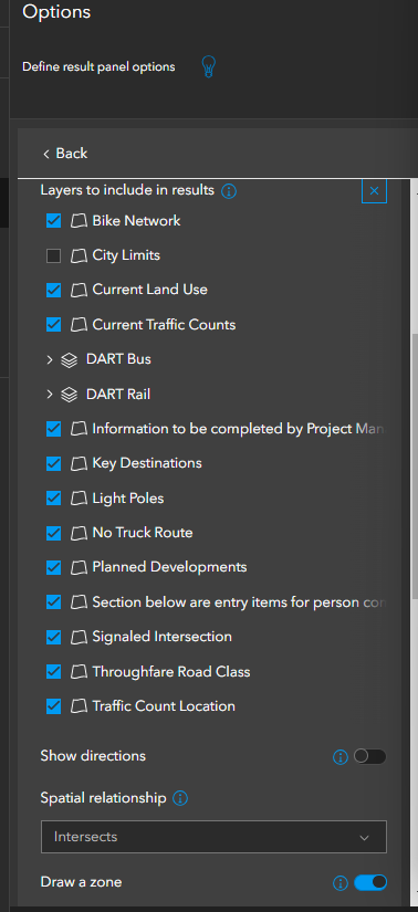

I've been asked to develop a tool that would create a 1/4 mile buffer and then create a report that would list all mapped items within that buffer (points, lines and polygons). I thought the Zone Lookup Instant App would be my saving grace instead of slogging thru a python script tool.
I have everything configured in the map and the app, and I am not getting the expected results when I use the line tool and a 1/4 mile buffer.  I've chosen "Feature Within a Zone" and the spatial relationship is "Intersects" all of the following:
Yet the results are missing some of the polygons (Current Land Use for example).

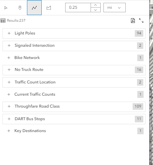

However, when I use the point and a radius, it only puts the polygon layers:
Ideally I want all of the above layers to show when I use the line tool. Is that possible?

Hi @ShariF,
There is currently an issue with the intersects option of the Zone Lookup Instant App - see Re: Instant app zone lookup spatial relationship I... - Esri Community.  A bug has been logged BUG-000170803 and it has the status of "In Product Plan" which apparently means it will be addressed in the next release or two.

The fix for this issue is scheduled to go out in the next release of ArcGIS Online later this year.
