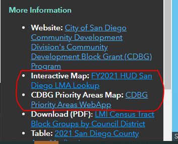

Hello, I'm updating the contents in the introduction panel on the publicly shared Zone Lookup App, but the app doesn't save any changes.

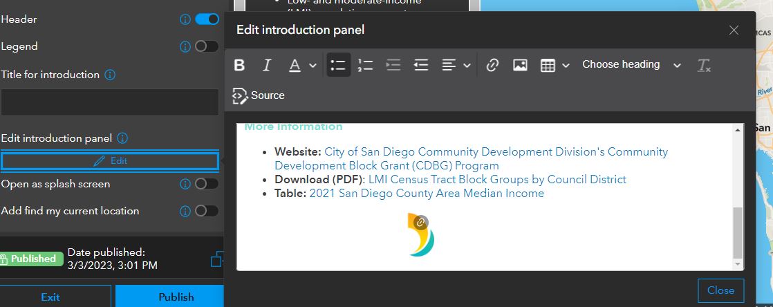

I could edit the contents in the edit window, but it did not reflect the introduction panel.
I removed two links in the edit window, then after closing the edit window, the two links I removed are still there.
I appreciate any help with my issue.

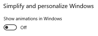

@RyanBohan  in some cases it looks like this was happening when prefers reduced motion is enabled. You can test to see if this property is turned off using the instructions at the bottom of this article: https://a11y-101.com/development/reduced-motion
RyanBohan
Hi @KellyHutchins,
Thank you for the suggestion.  I looked and mine was already toggled off.  I tried turning it on and off, and still unable to edit the introduction panel.
KellyHutchins
Esri Notable Contributor
Sorry Ryan I was wrong. It needs to be toggled On for editing to work. I know you said you tried toggling it on but wondered if you could test again?
RyanBohan
Hi @KellyHutchins,
Yes, turning on "Show animations in Windows" does allow you to update the introduction panel while on the cities network.  I was surprised a windows setting would affect my ability to update something on ArcGIS Online.
I'll have to remember to turn back on animations the next time I need to update the panel.  If it is helpful, I am on a windows 10 machine.
