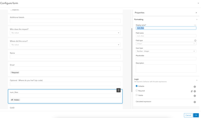

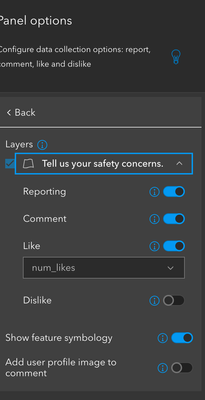

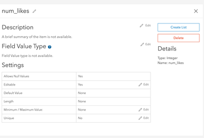

@SubaKrishnanHere are some screenshots and more info. Thanks
Thanks and yes I have a integer field for capturing likes. Here is a link to the DRAFT App
As well as setting I have for the hosted feature layer, Web Map Form, and App configuration.
Hi @ChristopherPollard Once you click on it, it will take you into the popup where you can add like or dislike. Could you check if you have configured a numeric field for like and dislike parameters for that layer. If you still have issues, please share your app I can take a look at it.
