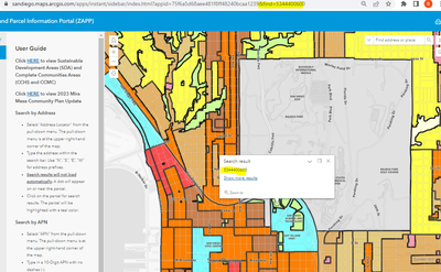

Trying to repeat the functionality in SideBar Instant app
https://sandiego.maps.arcgis.com/apps/instant/sidebar/index.html?appid=75f6a5d68aee481f8ff48240bcaa1...
The map does not zoom, the pop-up does not appear, only places a circle for the location.

With the find url param it's getting the first search result (in this case from the World Geocoder) and displaying that instead of using a more accurate match from one of the other locators. We'll look into improving that behavior in a future release.

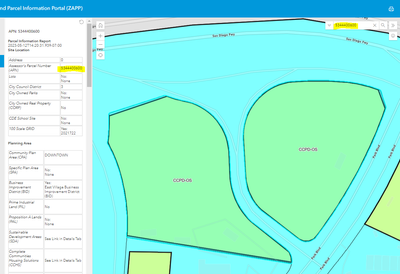

But in Sidebar you might be able to get what you want by setting up a custom url parameter. In the app configuration if you search for URL you'll see an option to setup a custom url param by specifying a parameter name and then choosing the layer and field the value comes from. In this example I set up a parameter called apn and use the APN field from the San Diego Parcels layer: https://jsapi.maps.arcgis.com/apps/instant/sidebar/index.html?appid=903d7cc412a8488f90c79d9bd49a3f2f...
