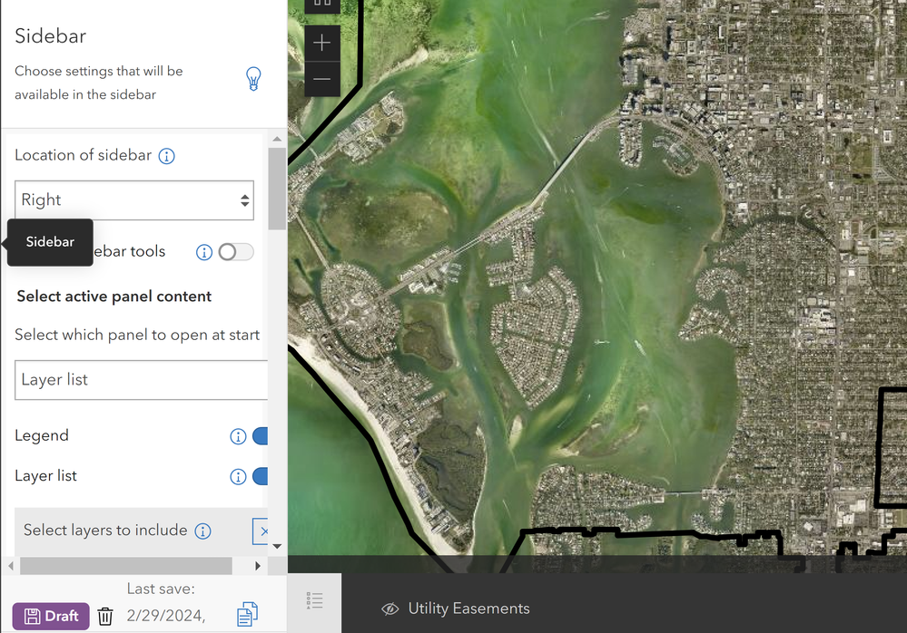

The Instant app slide isn't displaying in the correct location; regardless of the configured position, it consistently appears at the bottom of the map. This problem is specific to the portal, as the app functions properly on ArcGIS Online.

Thanks for sharing with us your Sidebar issue in Enterprise environment. This issue is a known issue and have been fixed in the upcoming ArcGIS Enterprise 11.3. Here is the defect info: BUG-000163830 for your reference.

Hooray!  The sidebar is back in place and functioning correctly at 11.3 @JShi_EsriStaff !  Thanks to you too @KellyHutchins !
