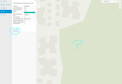

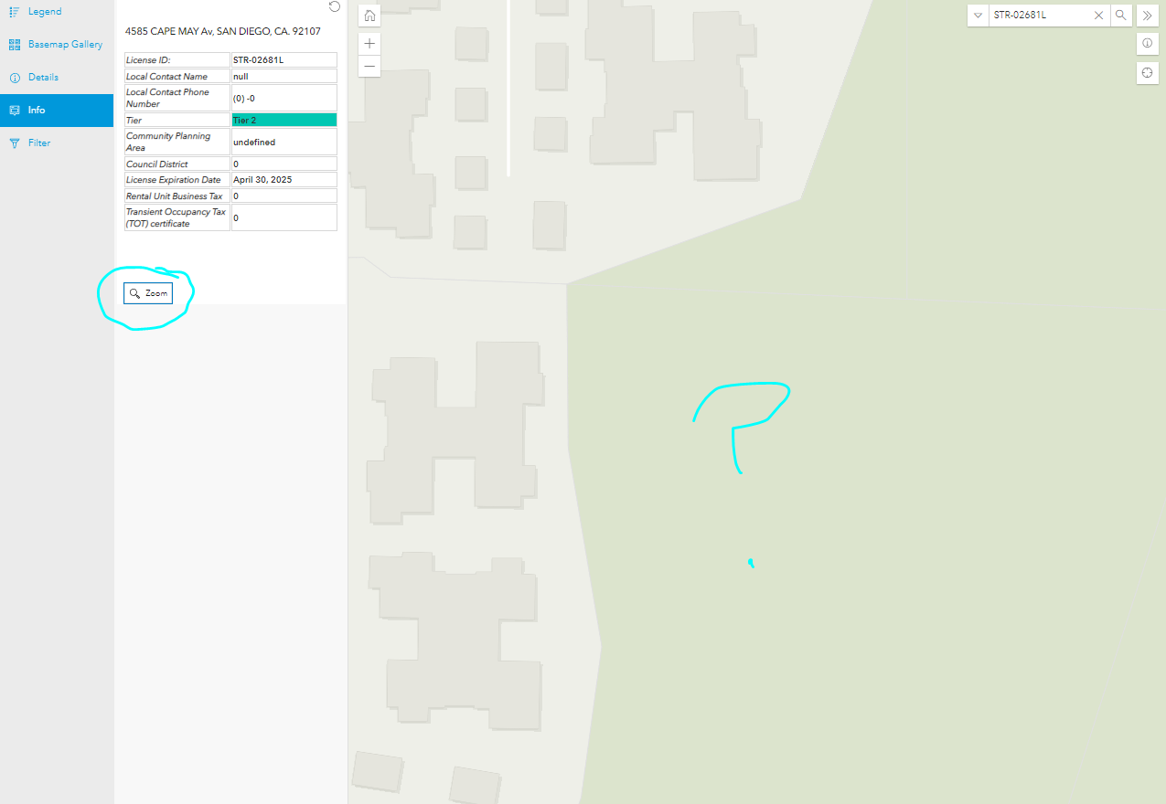

I am the using Search in the sidebar instant app, I configured a map layer to be searchable.
The map does not select or zoom to the searched feature.
The pop-up shows in the Info panel.  However, even zoom, seems to zoom in randomly on the map, the map should center around the point, and highlight it.
I have tried clearing my cache, and turning on "Show animations in Windows"
Thank you

I am seeing the same "random" zoom behavior as well when clicking on the Zoom button for the feature.

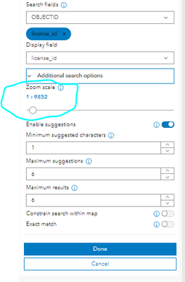

One thing I would recommend is to explicitly set the zoom level and see if that helps you out. Go into full setup mode and toggle this on and then set the scale.

AFAIK there haven't been any changes. Remember that there are two zoom settings that can be configured. One is for the Zoom link you see in the Sidebar panel when you click a feature, the other is an option zoom scale for when you've configure the Search tool. Maybe that is what you are noticing now.

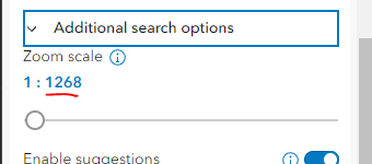

@BernSzukalskihow do I enter a custom scale number in the slider? Having only the slider doesn't give me enough precision. I can get it to go to 58, or 1268, or 3000, etc
