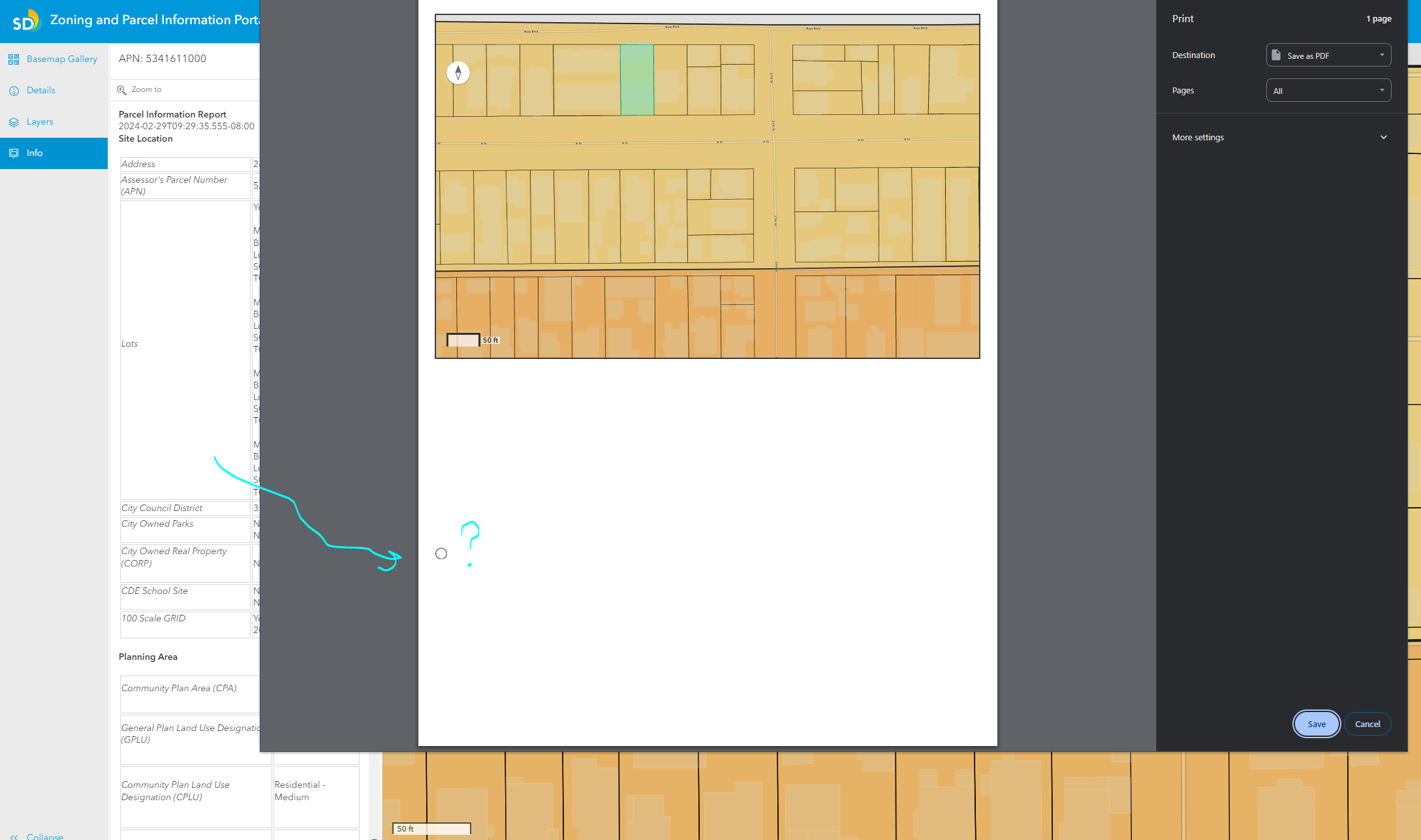

It looks like the Export/Print in the Sidebar Instant app broke after the recent AGO Release.  Being able to export the pop-up details is one of the most important features of this app.
Please return the functionality to include all pop-up details below the map when exporting/printing.

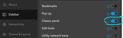

We made some updates to how the content is displayed in the side panel that may be affecting the export. You can go to Sidebar  in the configuration and choose the Classic Panel under the config settings to see if it resolves the issue.

The "Classic Panel" does improve the export/print results.

@KellyHutchins  However, if you choose classic panel, you can no longer see related records, which was an anticipated new feature. Please fix this!

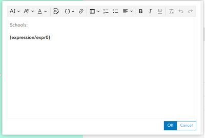

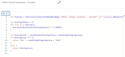

To help with the troubleshooting, I have recreated the bug using only AGO Living Atlas Layers and a single arcade expression.
In short the pop-up results can not be printed unless the Sidebar is in “Classic panel” mode.  The printing feature is one of the features reasons the Sidebar instant app is being used.

Pop-up modification:
USA Telephone Area Code Boundaries / areacode
Arcade Expression:
var Overlay = Intersects(FeatureSetByName($map,"Public School Locations - Current" ,['*'],false),$feature);
 var OverlayStatus = []
for (var f in Overlay){
  OverlayStatus[Count(OverlayStatus)] = (f.NAME);
 var OverlayList = concatenate(OverlayStatus, textformatting.NewLine)
if (OverlayList ==""){
  return "No:" + textformatting.NewLine + "None"
else {
  return OverlayList;
