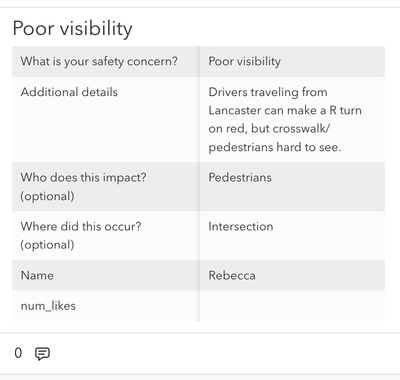

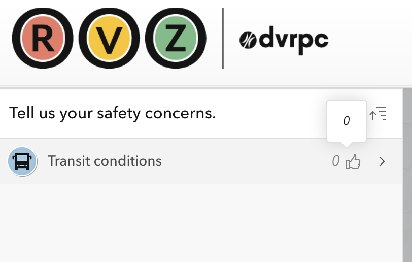

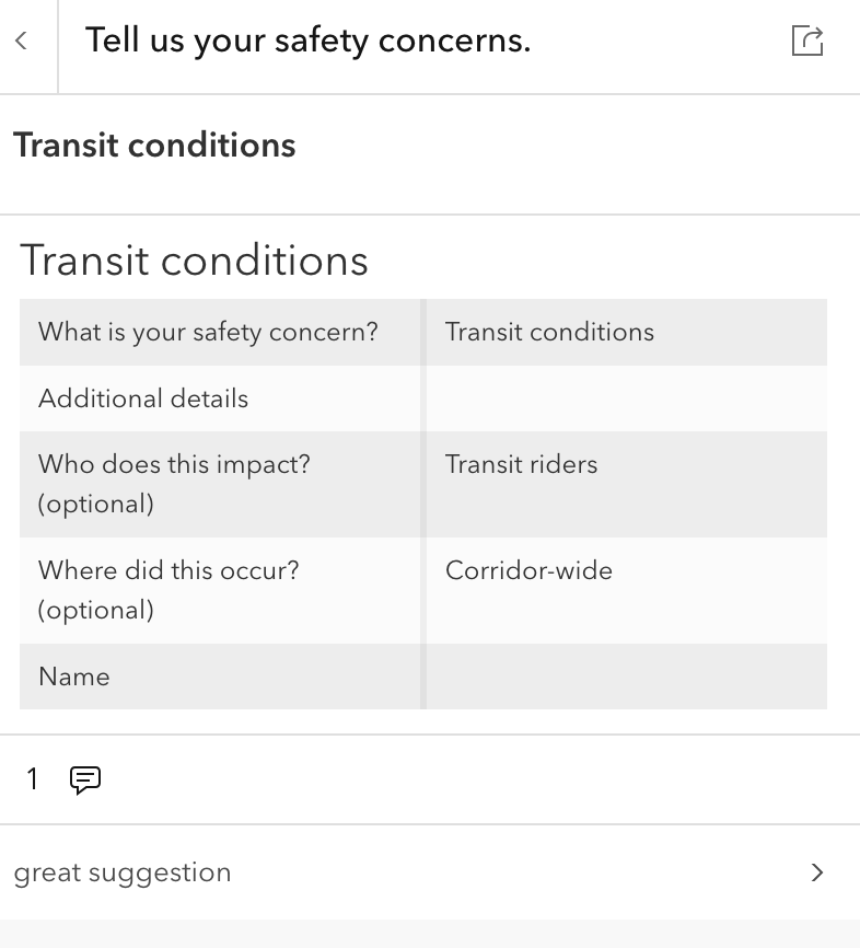

@SubaKrishnanYes the "num_likes" field is a numeric field within my hosted feature layer and all fields are editable. I am noticing that the Thumb Icon appears in the table of content that lists all submitted comments but the THUMB icon is missing on the detail/popup page. TOC.pngmissing_thumb.png

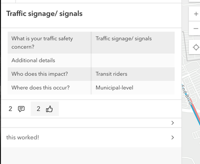

Ok, so creating the entire workflow using ArcGIS Pro solved the issue. Thanks for helping along the way. this worked.png
