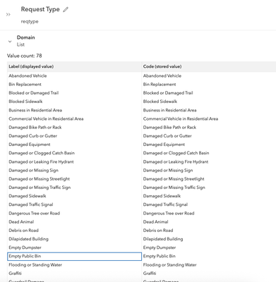

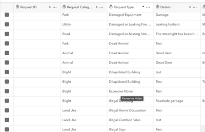

@MatthewMalone We think this is happening because the "Request Type” (reqtype) field has a coded value domain associated with it.  "Excessive Noise is in a field but isnt in the domain list so doesnt have an associated label which is causing the error. If you add it to the domain list or delete that row in the data it should work. Let me know how it goes.

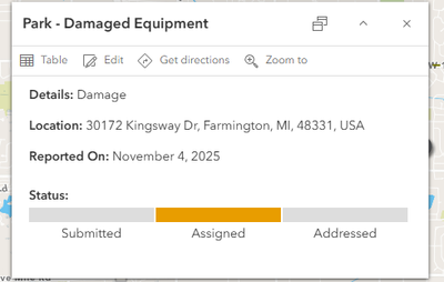

One thing we did modify was the pop-up for the Status.  Internally, our directors didn't prefer to have the four primary steps, so we changed it to show these three categories.  Maybe that's messing with the filter?  BTW, we had it set like that before and it worked.
MatthewMalone
That did it Suba!  All the entries up to now have been just for testing purposes, but we must have removed Excessive Noise as one of the types using the CSV update tool and Notebook.  I removed that row from the table and now the filter is loading and working as expected in both the CPR and Manager apps.
