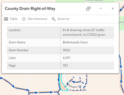

Hi @SubaKrishnan , thanks for pointing that out to me, I appreciate it. I tried it out and can see popups now, however they don't adhere to the settings from the webmap. I have popups turned off on a layer, but they still show up in the Reporter app. I have only two fields showing in another layer's popup, but I can see them all in the Reporter app. I tried making a new Reporter app from the same webmap, and I see the same behavior. It's the same layers as before: a map service published to our own ArcGIS server. Let me know if you'd like some screenshots.
Hi Chelsea. I'm glad that you're seeing the popups now. For the second issue, I'd like to know more. Are you referring to reporting or non reporting layers? Is that a hosted layer or map server layers? If you can send the map and app I can look into it, or some screenshots will help me too. Thanks!
@SubaKrishnan They are non-reporting layers on the map for reference and are map server layers not hosted on ArcGIS Online. The app is here. If you zoom in (try bottom right corner), orange hatching and blue drain lines will appear. They should have very simple popups, but unfortunately everything is seen, like OBJECTID. Here's how it looks in the webmap, just 5 attributes with no OBJECTID on the orange hatching:
