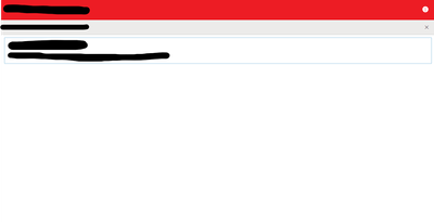

emoreno
Hi Kelly, that works! Thank you. There is now this empty grey space where the results count used to display, however. Would you know how to remove this from appearing once someone completes a search?

emoreno
That is perfect, I do not have any export options enabled so this will be just fine. Thank you for your help!
emoreno
Hi Kelly, thank you again for your help with this custom CSS solution. I showed it to my coworkers and they were very pleased! We were wondering if we could also use this custom CSS to minimize the amount of white space in the app itself, as we only ever have one popup appear and there is a considerable amount of white space under the popup. Please let me know, and I appreciate the help!
KellyHutchins
Esri Notable Contributor
@emoreno technically it would be possible but it would involve quite a bit of css and it would be very brittle and hard to maintain. However we are working on a full map layout option for Zone Lookup for situations just like yours so keep an eye out for it in a future release.
