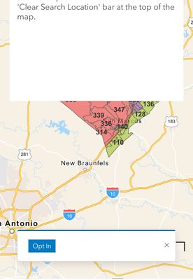

I have a Zone Lookup map that is keeps showing an "opt in" message at the bottom of the map.   I have provided a screen shot along with the URL of web map location.  https://www.haysdems.org/find-your-precinct/
Please tell me how to get this off?  I'm tired of all of the emails of everyone asking me what it means!

It looks like at one point you enabled google analytics and the consent message. Google analytics is now disabled in the app but the consent message is still enabled so its appearing as an empty opt-in. We'll make an update in a future release so that if GA is disabled but the Opt-in message is enabled it won't show but you can resolve this in your app by doing the following:
1. In the app configuration experience click Web Analytics in the lower left
2. Enable Google Analytics and click next
3. Disable the consent message and click submit or close
4. Now reopen the Web Analytics dialog and disable Google Analytics.
5. Publish your app
Test your app by opening it in a new private browser window and the opt-in message should be gone.
Kristine
Thank you for the clear instructions.   It worked perfectly!
