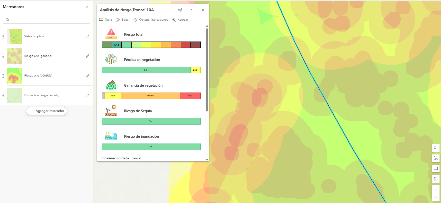

Hi, I have a problem with a configuration of a Sidebar template in Instant apps.
I have a map created in map viewer and I configured a expression to show the pop up in this way. If you click the line anyway, the pop up calculates percentages and distances of risk.

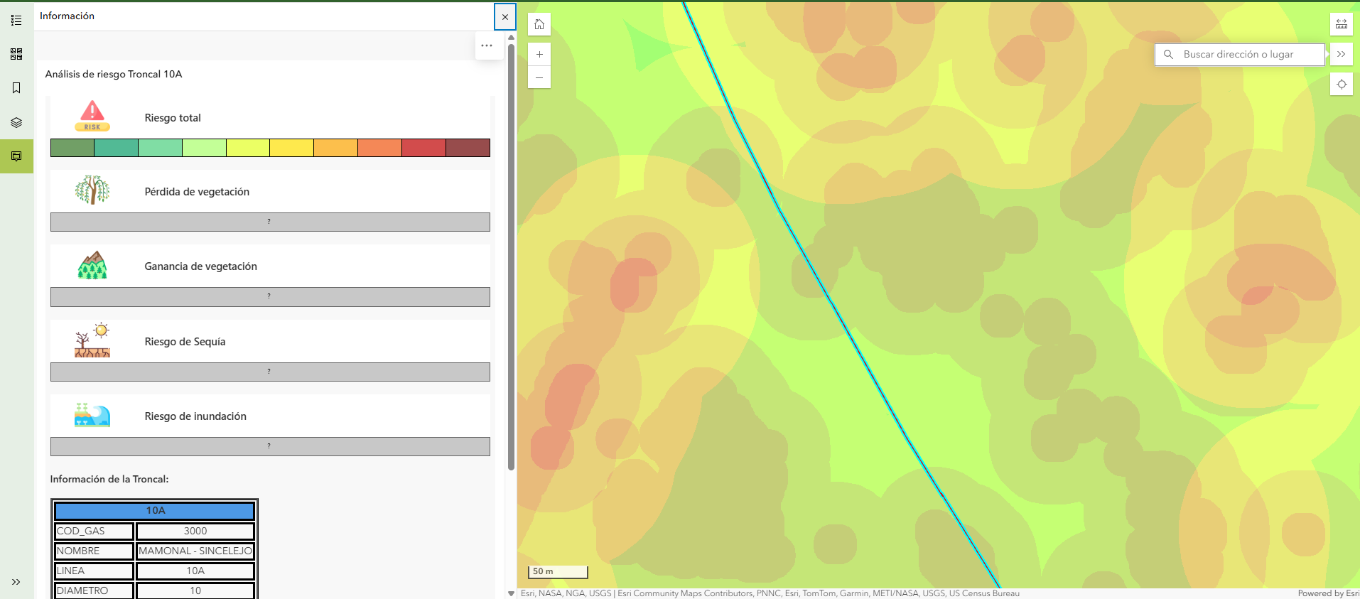

When I create the sidebar instant app, the pop up doesn´t work correctly in the info widget, the calculations doesn´t work.
Can you help me, please?

Can you go into your Sidebar app configuration and in the Sidebar section look for the Accordion panel option and make sure it is turned off. Then test your popups and see if they behave as expected.
NaslyTatianaVargas
Hi! Thank you for your answer
I tried this opction, turned off the accordion panel, but it still doesn't work
