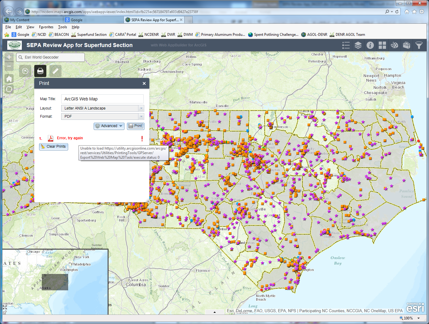

I created an AGOL project, using Web AppBuilder ArcGIS. I used the basic print widget. However, I cannot get it to work for me. I get the following message. This project is used by several people at work and some of them do not have a problem, but some do. I have tried Chrome and Internet Explorer and I get the same error. Any idea why this is happening? I have been wondering if it has something to do with my Adobe version. I am using X Standard.  Thanks! -Amy

Thank you for your response. I tried yours and it worked fine. Are you using this service: http://utility.arcgisonline.com/arcgis/rest/services/Utilities/PrintingTools/GPServer/Export%20Web%2...
I do not have my own print service, so I am trying to use that ESRI provides.

I am also using the Esri Default print service (Task: Export Web Map Task ) with my application. Are you consistently getting that error message with your application in Google Chrome as well. Sometimes, if you try again it might work.

I get the same error when under the advanced settings I have "Include Legend" turned on.  If I uncheck the box, I don't get the error and map outputs fine.  I need a legend so it doesn't help much.
