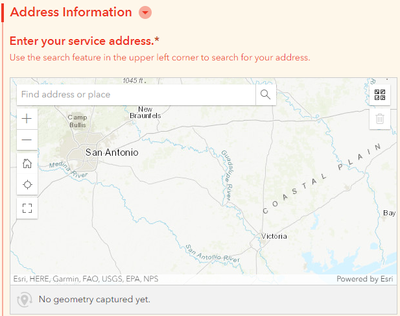

Hello ESRI community!
I am working on creating a zone lookup instant app where a customer inputs their address and the app returns a popup with a survey123 link if found in the appropriate zone. I was wondering if there was a way to pass the location information from the instant app and into the survey automatically so that a customer does not have to input their address twice, once in the app and once in the survey. Any direction on accomplishing this would be greatly appreciated. Thank you!

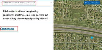

Yes. The link takes them to a web survey123 form and auto-populates a text question using the {find} value from the zone lookup app. Since yesterday I actually got this to mostly work, except my Survey123 text question is populated like this" "find= 123 main street....". So, the only part I'm missing is how to remove the "find=" part of the string from the Survey123 question.
zone lookup: user enters address/clicks map
a survey hyperlink appears that navigates them to survey123 web form. The expression I use for the link is this: <a href="https://survey123.arcgis.com/share/8d9375aa2dcd44d697ec06923ef089d6?field:property_address={find}">Open survey</a>
The {find} address transfers to my Survey123 question, however "find=" is carried along with it:
Hopefully this is a simple fix!

Unfortunately there isn't an approach right now that lets you remove the find= portion of the value on the instant app side. Not sure about the Survey 123 side.
In the next release of ArcGIS Online due out later this year you can use findParam instead of find in your url link and it will insert just the value not the find= portion .
