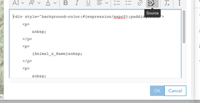

However I did some digging and it is possible to modify the background color using an arcade expression. It takes a bit of work and I think (at least in the example I'll share) it doesn't look that great.
Here's a test app showing the results.
https://www.arcgis.com/apps/instant/nearby/index.html?appid=488d3d71d295428998dcad18cd632faf
To achieve the above I followed the steps in this blog post from Lisa Berry.
https://www.esri.com/arcgis-blog/products/arcgis-online/mapping/bring-colors-from-your-map-into-your...
In her post she shows how to modify the text color based on an attribute value. I think the results of this look good and can add an identifying pop of color to the popup. In order to get the background color I use the source editor available in the Map Viewer popup editor and set the background color a div that surrounds all the popup content to the color defined in the arcade expression. One update I'd make if you were going to publish this would be to also define a color value to apply to the text depending on the background color. For example in my app you'll see that for features with the red background the black text is hard to read.
When editing the popup in source mode its important to know that not all html will be supported. This help topic outlines the HTML that you can use in online. https://doc.arcgis.com/en/arcgis-online/reference/supported-html.htm
