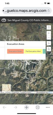

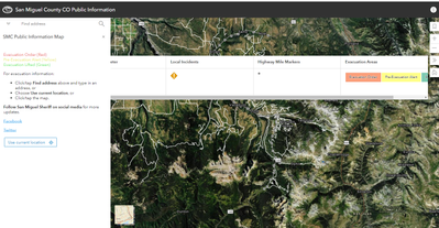

In my Nearby App, the legend opens horizontally and doesn't scroll far enough, so not all the features are visible. This is both on desktop and mobile. It's basically unusable. Is there a setting I'm missing?
