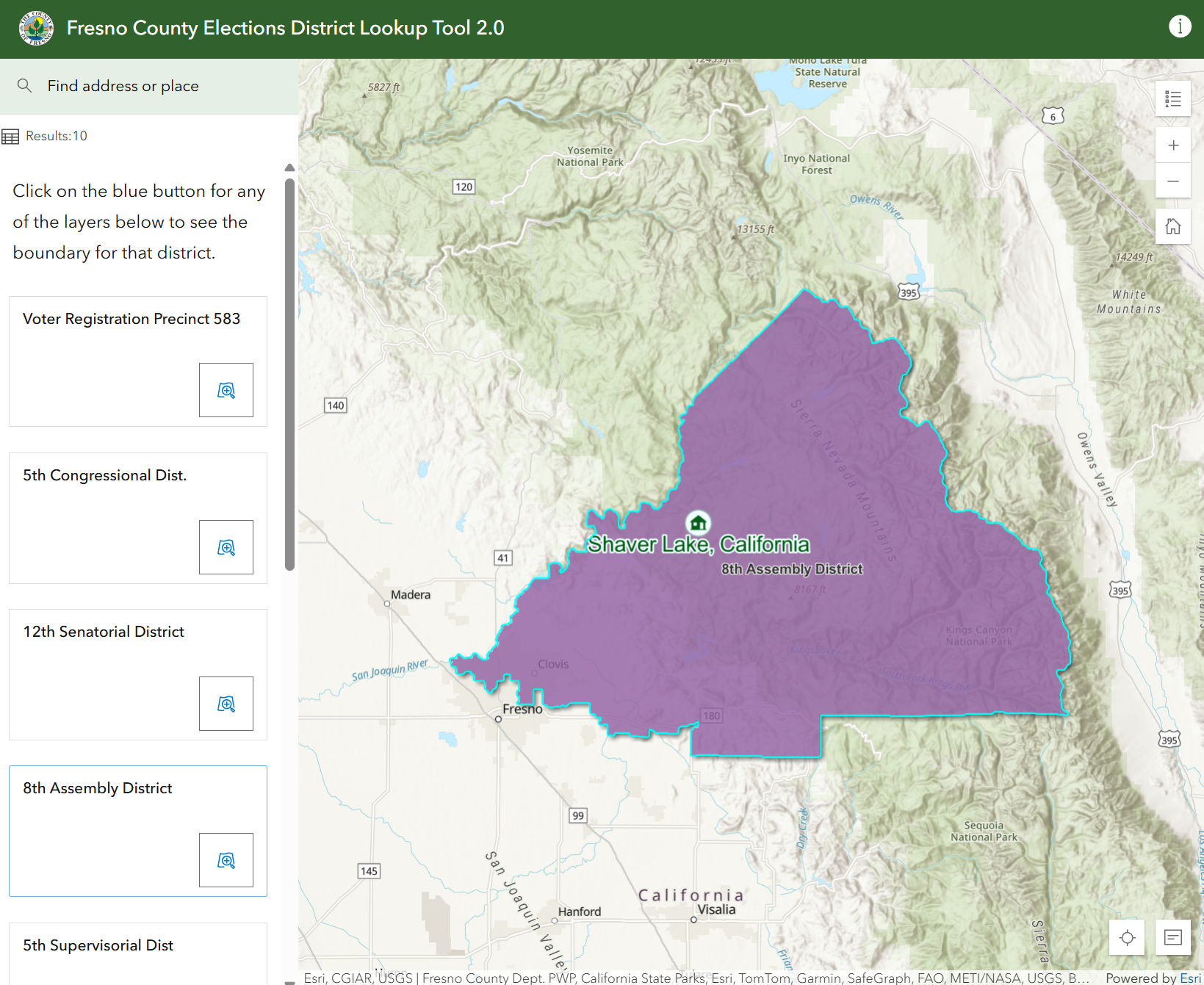

Hello everyone!
I was wondering if anyone else experienced this issue - I have created a public facing Instant App for Zone Lookup for our County Clerk's office, which you can view here:
https://cofgisonline.maps.arcgis.com/apps/instant/lookup/index.html?appid=20f00abd9ff14e8094f40d3a97...
Upon first load, everything is working as intended.  You can click on the map, or type in an address, and it will return a point and show the associated layers which you can then interact with individually.

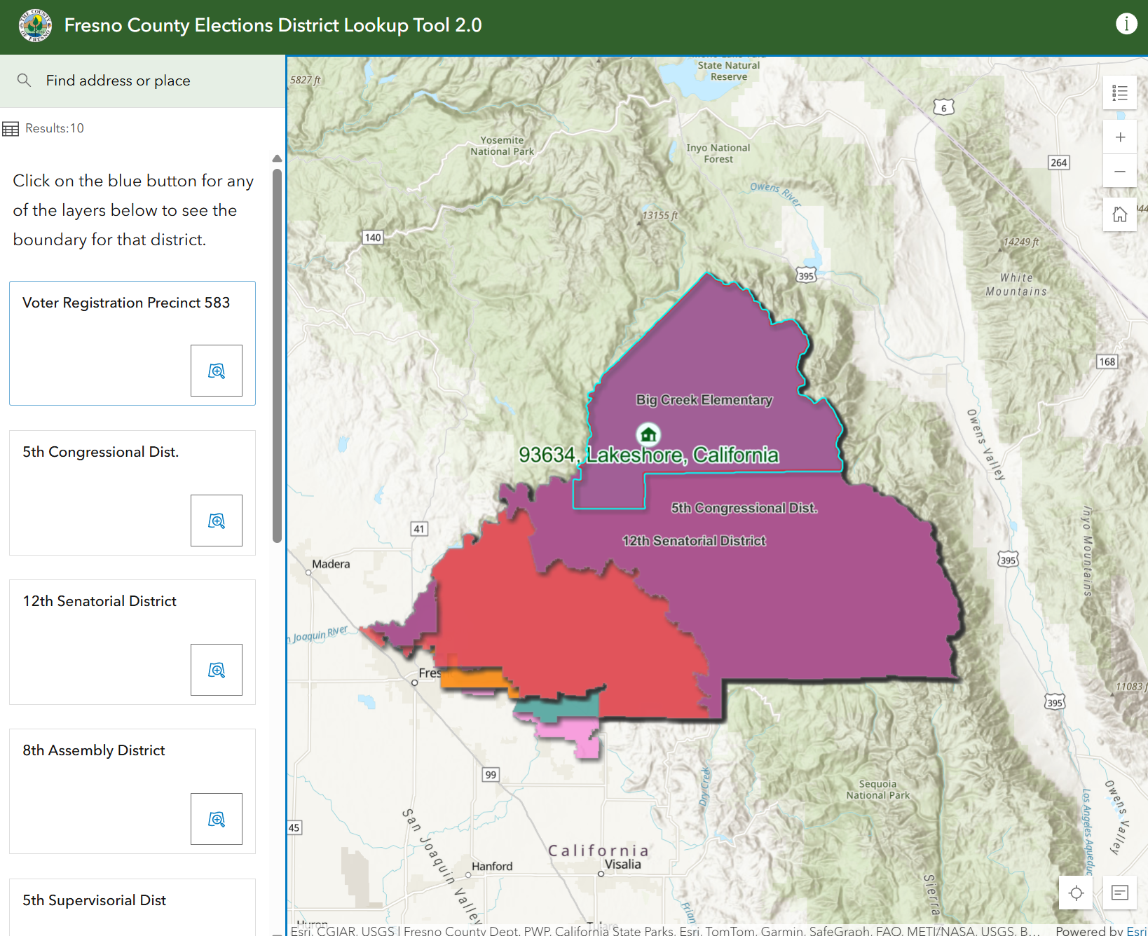

The problem that I am having though, is when you try to click on the map or use the address search a second time.  After this initial search, any resulting search will visually draw every layer all at once.  While it doesn't always look the worst, it definitely covers the ability for folks to see where each layer's boundaries are exactly at.
Is this intended functionality, or a bug?  I would like the app to function the same as it does in the very first search , for all additional searches.  I have tried this same functionality across multiple browsers, with identical results.

BethRomero
@BillyHopper It looks like this is a bug. We are looking at addressing it in the next update of ArcGIS Online.
BillyHopper
Awesome!  Would that be the October update or some time after that?
BethRomero
@BillyHopper Yes, it's scheduled to be part of the October update
BethRomero
@BillyHopper Your app should be working correctly after the October update and only show the zone zoomed to from the results list.
