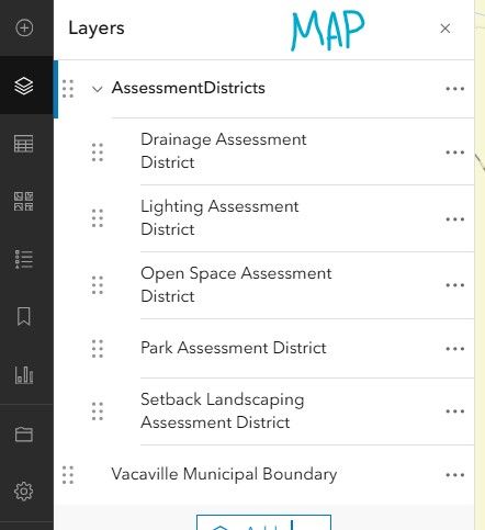

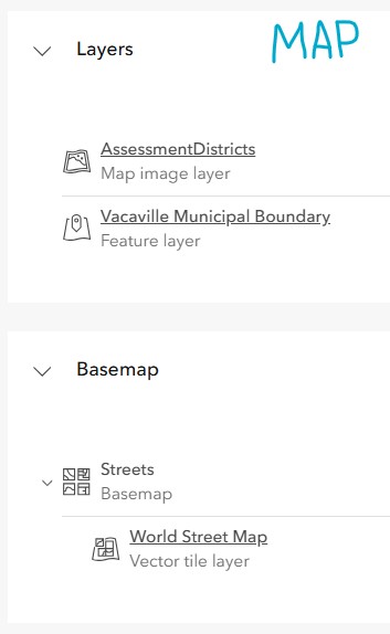

I'm helping re-configure an Instant App that is being fed by a simple Web Map, neither of which I built. The Web Map contains 2 layers and 1 basemap (see first image). When the Web Map is opened, I'm able to see that the main layer (Assessment Districts) contains 5 unique values (see second image).

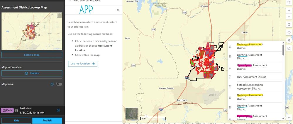

The issue here is that when the Web Map is added to the Instant App, the Instant App Legend and Layer List both show duplicates (see third image) for each of the 5 unique values that come from the main layer within the original Web Map.
The Instant App template used was Zone Lookup (which allows users to search for locations within a zone or region. Organize results returned in the search by using the group results by layer option).

Web Map LayersWeb Map Layers
Web Map's Main Layer DesignationsWeb Map's Main Layer Designations
Duplicate Designation Values in Legend and Layer ListDuplicate Designation Values in Legend and Layer List

Ok I think I found the issue. It looks like if you have a map image layer then there will be situations where the layers are duplicated. But as a workaround, I ran a quick test and it looks like you can remove the map image layer from the legend in the Map Viewer to remove the duplicates.
To do this select the main layer - in this example its called "AssessmentDistricts" then use the three dots to select "Show Properties" which will open the properties panel then you can unselect "Show in map legend".
