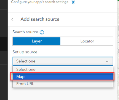

@GaryMorris2 Did you add the layer search by adding the feature layer's URL?  Could you try adding the search source through the map option (see the image below)? The pop-up information was defined in the map, so adding it through this method will open the pop-up.
