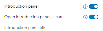

Hello,
I have a Zone Lookup Instant App and it is currently configured to Open the Introduction Panel on Start (see below).
However, when I open the app the panel does not appear. I can open it using the Open Introduction Panel button but I need to Open upon start.
Thanks!

Are you able to share your app?  Could you try testing it out in incognito or private browsing mode and see if it opens when first loaded there?

Ahh, it works in Private Browsing! Why is that? Thanks for the help!

You could be using an older version of the Zone Lookup app.  Was this app created with ArcGIS Online? If so, could you verify the word "instant" in the URL?  Or was it created with Enterprise, and what version?  The original version of this template had the info panel open just on the first visit to the app (for that browser session).  The instant app version of Zone Lookup should have the info panel open every time unless results are showing.
