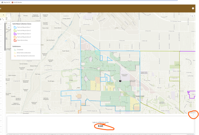

Hello, I noticed a few other things regarding the UX on the Zone Lookup Instant App.
The first is something simple (I think). The expand and collapse arrow seems to be backwards.
The second thing I think needs to be fixed or enhanced is the formatting of the statistic panel. There should be a way to show the full number like 7,500 instead of 7.5K. It does not give you the arcade option on this particular instant app. In Dashboards, it does.
