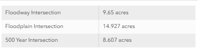

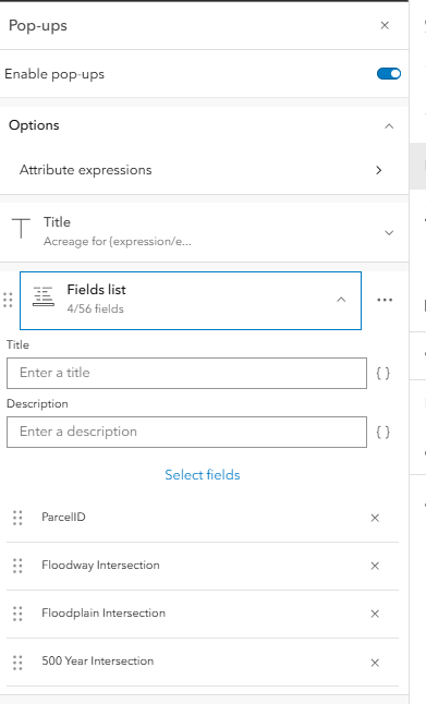

I used attribute expressions in my web map to get the acreage of floodway, 100-Year floodplain, and 500-Year floodplain intersecting owner parcels. The flood type layers come from the living atlas FEMA feature service and the owner parcels is one that comes from my organization and has sensitive information. Thus,  I did not want to edit the original data itself and custom pop-up expressions allowed me to  execute these calculations without permanent alterations to original attribute table. So in my web map it looks like this where I used my attribute expressions as a field and then the pop-up displays in that tabular form.
