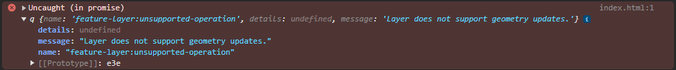

If anyone is still looking for a solution to this issue. There is a way to get it working. Looking at the browser console the following error was being returned within the Attachment Viewer Instant App.

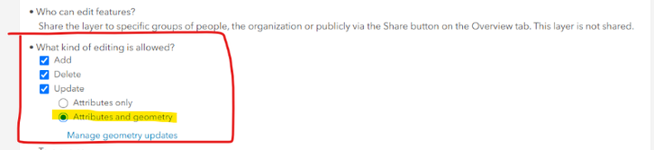

To fix and get it to save edits in the Attachment Viewer app we had to change the settings on the Feature Layer under the "What kind of editing is allowed?" from Attributes Only to Attributes and geometry and that fixed the issue and changes would then save.
@KristaMcPherson this is maybe why you were not able to replicate the issue? It appears to only cause a issue when the feature layer is set to "Attributes only" With the Attachment Viewer Instant App I would not expect geometry editing to be required to make updates.

JessicaTaylor
Thank you Ryan,
This issue has been bugging me for months, your fix of attributes & geometry I can now save edits as a field worker.
As you mention, geometry editing wouldn't be expected to be required to make updates.
Thanks again
